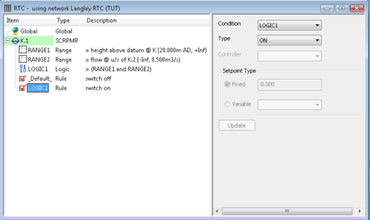

RTC Window Editor - Rule Pane
A Rule controls the setpoint of a Regulator. When the coditions on which a rule depend are TRUE the rule takes effect.
The Rule pane contains the following fields:
Condition
The label of a Range or Logic condition previously defined for this regulator or included in the Global definitions. If the Condition is blank, the rule is assumed to be TRUE.
The last TRUE rule for a regulator will be the active rule at a particular time during the simulation
