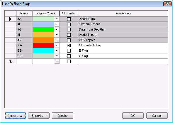

Create user defined flags
To create data flags
  1. Select Database managementUser defined flags from the File menu. The User Defined Flags dialog is displayed.
  2. Type in a four-character name to identify the flag. You must not include the # character.
  3. In the Description field, type a description of the flag.
  4. Double-click in the Display Color field. Select a colour from the palette. The program will use this colour to highlight data items associated with this flag.
  5. Click on the Close button.

Deleting flags
Only users with Administrator privileges can delete flags. Other users may mark flags as obsolete.
Flags can be deleted using the User Defined Flags dialog.
To delete flags
  1. Select the rows by clicking on the left hand end of the row.
  2. Click Delete or press the Delete key on your keyboard.
Note: The standard (#) data flags can never be deleted.
Obsolete flags
Users without Administrator privileges cannot delete data flags from the list, but can mark them as obsolete.
Flags can be marked as being obsolete by checking the Obsolete check box in the User Defined Flags dialog. Data which already has an obsolete flag is still displayed with the flag, but the obsolete flag is not displayed in the list when editing a flag field. Therefore no new data items can be assigned the obsolete flag.
