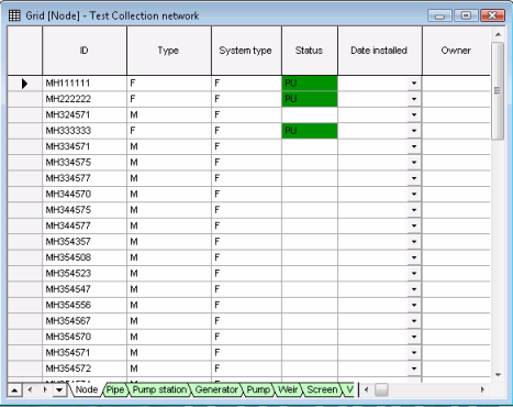

Click on the tabs at the bottom of the grid window to switch to different views within the grid.
Use the and buttons to scroll backwards and forwards through the tabs displayed at the bottom of the window (this does not change the currently active tab).
Use the and buttons to jump to the first/last tab on the view.
Example of Grid Window Tabs taken from InfoAsset Manager
The currently active tab is coloured white. The tabs for network objects (objects that are visible on the GeoPlan Window) are coloured in green. Tabs for sub-objects that define specific characteristics of network objects are coloured yellow.
Press CTRL+Page Up and CTRL+Page Down to switch between tabs by moving to the next tab on the left or to the next tab on the right respectively (This changes the currently active tab).
