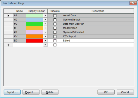

User Defined Flags dialog allows you to set up your own data flags. Network object data fields can be assigned a data flag indicating, for example, where the data came from or how reliable you consider it to be.
To open the dialog, select Database management
User defined flags from the File menu.

To specify your own data flag:
- Type in a four-character name to identify the flag.
- In the Description field, type in a description of what the flag indicates.
- Double-click in the Display Colour field. Select a colour from the palette. Any data items that have this data flag will be highlighted in the chosen colour.
- After entering the required data flags, click Close.
