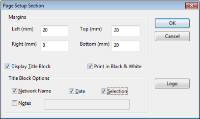

Long Section Page Setup Dialog
The Section Page Setup dialog is used to set up the printing options for the Long Section View and the Cross Section View .
To display the dialog, select Page setup from the File menu when the Long Section Window or the Cross Section Window is the Current Active Window.
Use the Title Block Options to print a banner at the top of the page showing additional information.
Click the Logo button to display the Print Setup Logo dialog, which allows inclusion of a user defined title and logo that will be printed at the bottom of the page.
