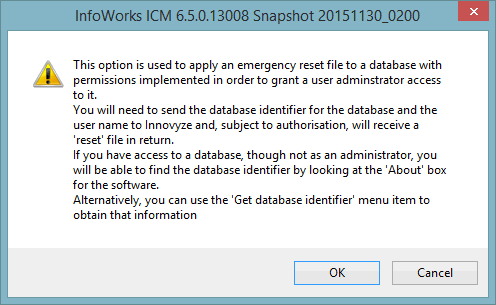

Resetting Permissions
In the event that it is necessary to reset user permissions for a database, it is possible to grant a user administrator access to a database via an emergency reset file.
An emergency reset file can be obtained from
Innovyze. In order to generate the reset file, database identifier and user name information will be required.
In order to apply the emergency reset file to a database and grant administrator access to a user:
