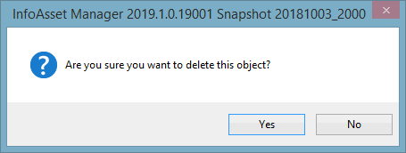

Deleting objects
To delete an object
  1. Right click the object to be deleted in the tree view.
  2. Select Delete from the context menu.
  3. Note: A warning message will be displayed if the object to be deleted is a user-defined object with a relationship that has a specified minimum number of objects of this type that must be associated with it, and by deleting the object, this minimum number will not be maintained. See the User Defined Relationship dialog for further information.
  4. A message is displayed, asking the user for confirmation:
  5. Click on Yes to proceed.
  6. The object is deleted.
  7. Tip: This operation can be undone by using the Undo option of the Edit menu or the Undo last data transaction button of the Edit toolbar.
