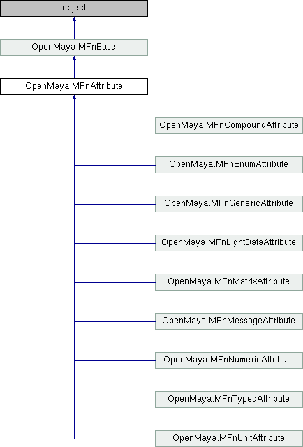

Inheritance diagram for OpenMaya.MFnAttribute:Public Member Functions | |
