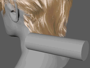

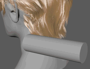

- Preserve Deformation
- When on, the hairs maintain their shape and deformities created by the collisions with the colliding objects, which makes multiple collisions cumulative. When off, the hairs deform when they intersect with collisions objects, then return to their original shape after the collision occurs.
				Preserve Deformation is off by default.
				 Preserve Deformation: On
 Preserve Deformation: Off
