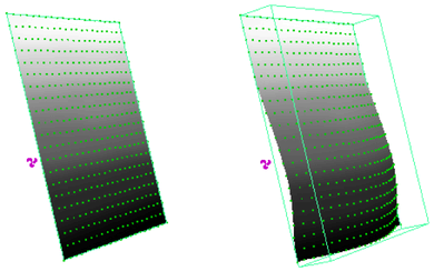

Using the Paint Soft Body Weights Tool, you can set goal weights on a soft body on a per particle basis by painting on the soft body surface. The tool provides color feedback so you know which parts of the soft body have particles with different goal weights. Weights display as a range of grayscale values, with a weight of 1 displaying as white and 0 as black.
To paint goal weights on a soft body
The Paint Soft Body Weights Tool automatically detects the soft body and goalPP attributes and selects the soft body for painting.

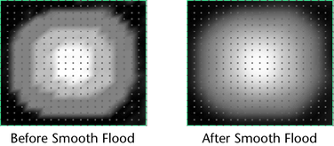

Flooding soft body goal weights is like taking a huge brush and applying its settings to all the particles on the soft body. When you flood a soft body, Maya changes the goal weight of each particle on the soft body according to the value and operation set for the Paint Soft Body Weights Tool.
To flood a soft body, follow the steps under Color Feedback setting; Select Cluster Mode hotkey;To paint goal weights on a soft body, but instead of painting in step 5, click the Flood button or use the hotkey Alt + f (Windows and Linux) or Option+f (Mac OS X).
