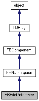

Objects Containing class. More...

Public Member Functions inherited from FBNamespace | |

Public Member Functions inherited from FBComponent | |

Public Attributes inherited from FBPlug | |
This class is an interface to manipulate object's containing in the scene.
