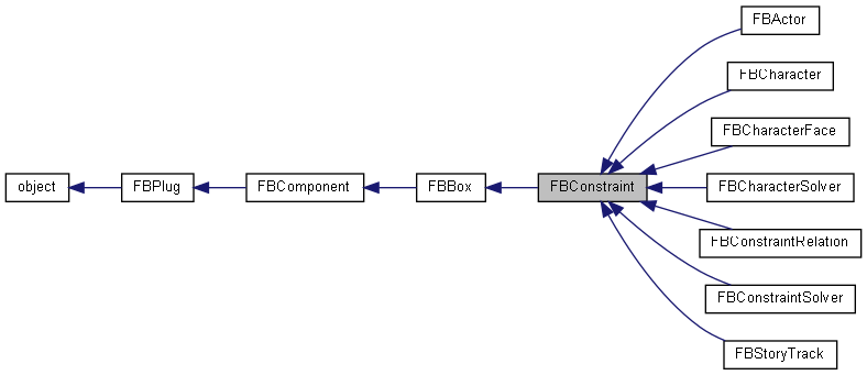

Base class for constraints. More...
#include <pyfbsdk.h>
| FBConstraint | ( | str | pName | ) |
Constructor.
| pName | Name of constraint. |
