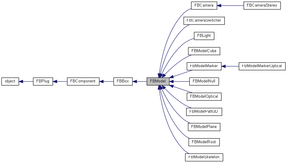

Model class. More...
#include <pyfbsdk.h>
Inheritance diagram for FBModel:
