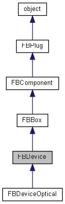

Inheritance diagram for FBDevice:

Detailed Description
Base Device class.
Cannot be instantiated from Python.
# This example shows how to create a Vicon Stream Device (a third-party device), initialize it and add it to the scene:
# Create the Vicon Stream Device
viconStreamDevice = FBCreateObject( 'Browsing/Templates/Devices', 'Vicon Stream Device', 'Vicon Stream Device' )
if viconStreamDevice:
# Initialize the device
viconStreamDevice.DeviceOperation( kDeviceOperations.kOpInit )
# Import the device to the current file
FBSystem().Scene.Devices.append( viconStreamDevice )
print( 'Vicon Stream Device initialized and added to the scene' )
else:
print( 'Vicon Stream Device not found' )
