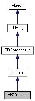

Material class. More...
#include <pyfbsdk.h>

Material class.
See samples: MaterialAndTexture.py, TextureAnimation.py, VideoInput.py, VideoMemory.py.
