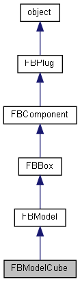

Cube model class. More...
#include <pyfbsdk.h>
Public Member Functions | |
| FBModelCube (str pName) | |
| Constructor. More... | |

| FBModelCube | ( | str | pName | ) |
Constructor.
| pName | Name of cube. |
