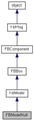

Null object class. More...
#include <pyfbsdk.h>
Public Member Functions | |
| FBModelNull (str pName) | |
| Constructor. More... | |

Null object class.
| FBModelNull | ( | str | pName | ) |
Constructor.
| pName | Name of null. |
| float Size |
Read Write Property: Size (not related to scaling).
