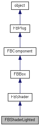

Inheritance diagram for FBShaderLighted:
