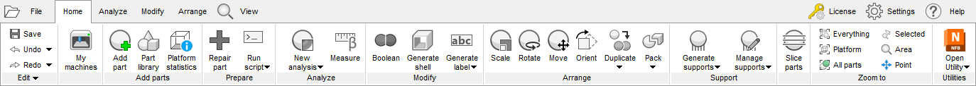

Netfabb's window is where you work on parts and prepare them for additive manufacturing.

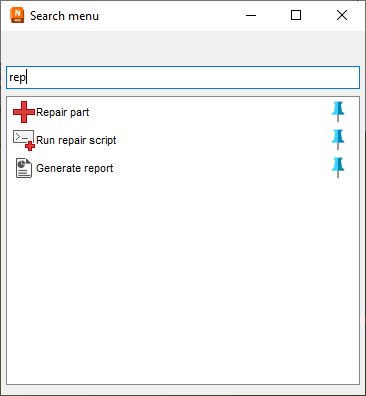

Provides a function to search and execute commands from almost anywhere
You access Netfabb's functions through several of ways:
The Home tab collates the items used most often during preparation.
You can also create your own tab in the main menu with the commands you need.
Command search: Most commands sorted into the various main menu categories are accessible through a common search function: Open the search dialog, begin typing the name of the command, or a word likely to be contained in the command's name, and the search narrows down the possible matches as you type. Then select the command so found to execute it right there.
Find the right command with just a few keystrokes.
