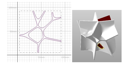

The display occupies the largest section of the user interface. It provides the 3D visualization of a project, including parts and the platform. The style of visualisation adjusts when the currently performed task requires it, such as when making repairs.
The display is also used to show slice contours and hatches.
Left: The two-dimensional view on the slice of a part in the slice commander. Right: A part in repair.

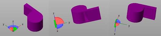

To give an indication of the viewing angle relative to the build platform (read: the global coordinate system), a representation of the coordinate system is available in the bottom-left corner. It shows the three cardinal axes as well as the three planes formed between them. To help recognizing the orientation, not only are they colored the same as the axis that stands vertically upon them (X axis - YZ plane - blue, Y axis - XZ plane - orange, Z axis - XY plane - green), they are also adjusted in size. The further the planes are away from the camera, the bigger they are drawn.
Tip: Click the planes to orient the view such that the respective plane becomes parallel to the display.
Three different perspectives and the perspective indicator in the matching orientation.
The perspective indicator's appearance is adjusted at Settings > Settings > Display > Perspective indicator.
