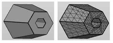

To show the triangle mesh
  1. Click View > Highlight triangles.
  2. Tip: You can also right-click a part and choose Highlight triangles to show the triangles for just the selected part.
