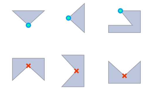

Definition of "edge" in the context of this support action
Part sections seen from the side. The top row shows edges supportable with this action, the bottom row shows edges ignored by it. Not shown: Angle minimum of 40° between normals of triangles along a qualifying edge.
