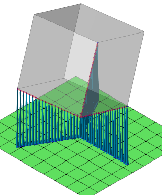

Edge with bar support

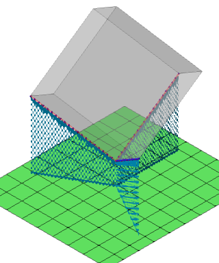

Down-oriented, critical edges are supported by tracing them with a row of bar supports each
Edge with polyline support
single-wall polyline supports.

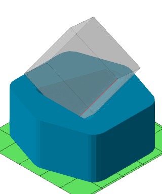

Area with volume support
Critical areas of downskin receive volume supports.

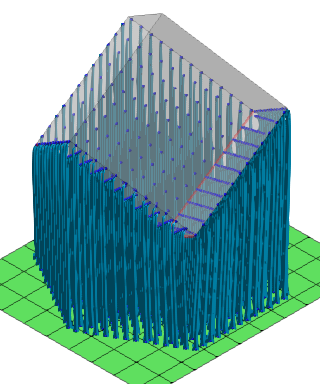

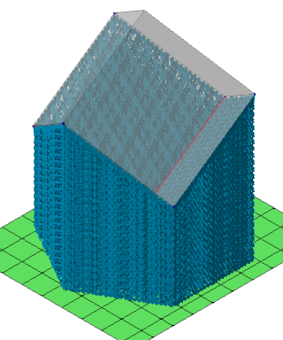

Area with bars support
Critical areas of downskin receive bar supports. Bar supports may be branched into bouquets.
If the area contains local points, these are supported with priority, and the regular grid of bar supports is adjusted so as to avoid duplicate support bars in close or same positions.

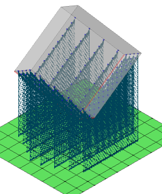

Area with polylines support
Critical areas of downskin receive supports in the form of sets of straight polyline walls in parallel orientation.

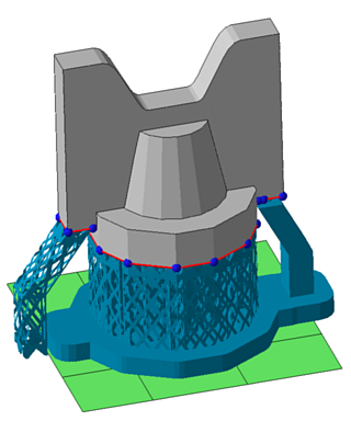

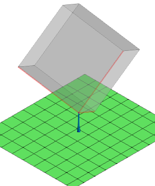

Down-oriented point bar support
Critical, down-oriented corner points or clusters receive bar or few bars each.

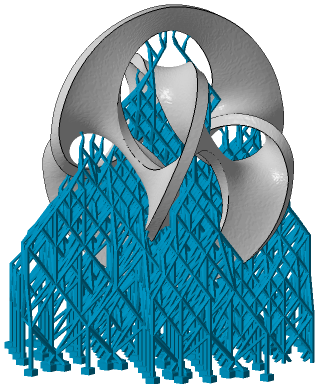

Adaptive Lattice Bars
This action generates a regular volumetric scaffolding from lattice cells of interconnected bars. This makes very rigid bar support possible in areas that have undercuts themselves while mimizing part-to-part support. The bar density is also dependent on the individual support requirement: If there is enough free volume available, multiples of cells are recursively collapsed into singular larger cells.
The scaffolding of bars supports otherwise difficult-to-reach surfaces well.
