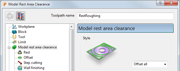

  1. In the Explorer, right-click the Roughing toolpath, and choose Settings in the context menu.
  2. In the Model Rest Area Clearance dialog, click Create a new toolpath based on this one button.
  3. A copy of the toolpath is created with the suffix '_1'. Enter RestRoughing in the Toolpath name field to rename it.
  4. Select the Rest Machining option. This switches the strategy to Model rest area clearance strategy and enables the Rest page.
