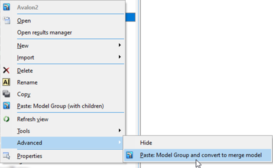

Consequently, any version-controlled objects with the yellow icon indicating the lock-style method will need to be converted to merge-style before being transferred to a cloud database. Note that the easiest way to convert these objects is to copy and then select Advanced Paste and convert to merge model from the right-click options menu.
