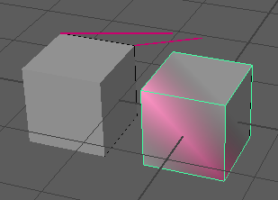

次の例に、2 つのオブジェクト(smcPlane と smcPlane1)の頂点に 2 つのメタデータのストリーム(StreamOne と StreamTwo)をアタッチする方法と、ビューポート 2.0(Viewport 2.0)でデータストリームを 1 つずつ視覚化する方法を示します。ビジュアライゼーションを無効化することで、表示されます。
// Start a new scene and create two cubes file -new -f; polyCube -n smcPlane -ch off; pickWalk -d down; move -r 1.5 0 0 ; polyCube -n smcPlane1 -ch off; pickWalk -d down; // Define the data structure and create and attach the data streams to the two shapes dataStructure -format "raw" -asString "name=ColorStruct:float[3]=Color"; addMetadata -streamName "StreamOne" -channelName "vertex" -structure "ColorStruct" smcPlaneShape smcPlane1Shape; addMetadata -streamName "StreamTwo" -channelName "vertex" -structure "ColorStruct" smcPlaneShape smcPlane1Shape; // Assign metadata values to the two streams editMetadata -streamName "StreamOne" -value 0.25 -value 1.25 -value 2 -index 1 smcPlaneShape; editMetadata -streamName "StreamTwo" -value -2 -value -0.5 -value 2.5 -index 2 smcPlaneShape; editMetadata -streamName "StreamTwo" -value -4 -value -0.5 -value 2.5 -index 3 smcPlaneShape; editMetadata -streamName "StreamTwo" -value -1.25 -value -0.75 -value 3 -index 4 smcPlane1Shape; editMetadata -streamName "StreamOne" -value 6 -value 2 -value 3.5 -index 5 smcPlane1Shape; editMetadata -streamName "StreamOne" -value 2 -value 0.5 -value 1 -index 6 smcPlane1Shape; // NOTE: By default, all streams are hidden. // Activate visualization of "StreamOne" for one cube. Use color mode. showMetadata -stream "StreamOne" -member "Color" -dataType "float[3]" -method "color" smcPlane1Shape; // Metadata is now visible. // Auto remap the data range of the values in the stream. showMetadata -stream "StreamOne" -member "Color" -dataType "float[3]" -method "color" -auto smcPlane1Shape; // Enable color interpolation to extrapolate color to the faces surrounding the vertices showMetadata -stream "StreamOne" -member "Color" -dataType "float[3]" -method "color" -interpolation true smcPlane1Shape; // Activate visualization of "StreamOne" for the other cube. Use string mode. showMetadata -stream "StreamOne" -member "Color" -dataType "float[3]" -method "string" smcPlaneShape; // Metadata is now visible on both cubes. // Now, activate visualization of "StreamTwo" for the second cube. Use ray mode. showMetadata -stream "StreamTwo" -member "Color" -dataType "float[3]" -method "ray" smcPlaneShape; // The rays appear too long. // Scale the length using the rayscale flag. showMetadata -stream "StreamTwo" -member "Color" -dataType "float[3]" -method "ray" -rayScale 0.3 smcPlaneShape; // The visible metadata has now changed, and you have now used all three methods of display. // Deactivate the stream. To turn off visualization on an object, specify the stream name and use the off flag. showMetadata -stream "StreamTwo" -member "Color" -dataType "float[3]" -off smcPlaneShape; // Now metadata is no longer visible on the second cube (smcPlaneShape)
この例では、StreamTwo はレイの長さスケール(Ray length scale)を 0.3 に設定した X 線モードで smcPlaneShape 上に視覚化され、StreamOne はデータ範囲が自動的に再マップされ、カラー補間が有効なカラーモードで smcPlane1Shape 上に視覚化されます。
