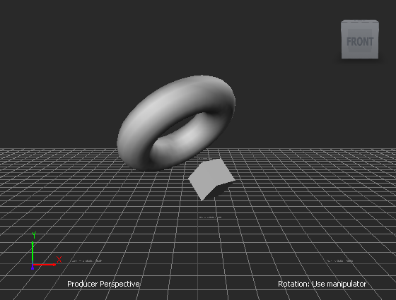

In the code sample below, a torus model is created, and parented to the cube created above. Any subsequent geometric transformations applied to the cube will also be applied to the torus.
# Create a torus, and position it in space.
torus = FBCreateObject( 'Browsing/Templates/Elements/Primitives', 'Torus', 'Torus' )
torus.Scaling = FBVector3d(5, 5, 5)
# Set the torus' parent as the cube. Any local transformations
# applied to the torus will now be in relation to the cube's frame
# of reference.
torus.Parent = cube
# Translate the torus by 5 units above the cube.
torus.Translation = FBVector3d(0, 5, 0)
torus.Show = True
# Rotate the cube by -45 degrees along its parent's x axis,
# and by 45 degrees along its parent's y axis.
# This will now also rotate the torus accordingly.

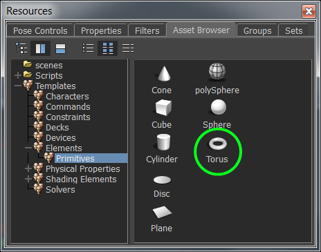

cube.Rotation = FBVector3d(-45, 45, 0)Note: When you are a creating primitive element such as a torus or a sphere, the FBCreateObject() function requires that the third parameter be identical to the second parameter. The second parameter must also match the name of the primitive you wish to create from the asset browser (e.g. 'Torus').
Sample Viewport Output:
