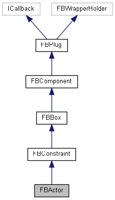

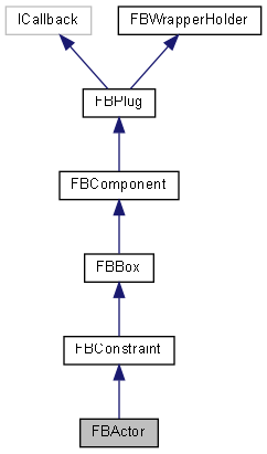

FBActor is used to link motion data to a character. More...
#include <fbcharacter.h>

Public Member Functions inherited from FBConstraint | |

Public Member Functions inherited from FBBox | |

Public Member Functions inherited from FBComponent | |
