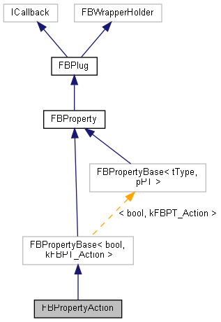

Property: Action Action property to trigger function. More...
#include <fbproperties.h>
Definition at line 1313 of file fbproperties.h.
