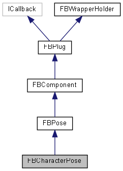

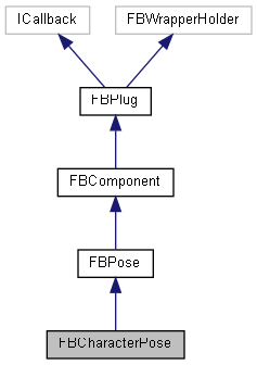

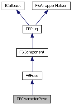

Inheritance diagram for FBCharacterPose:
