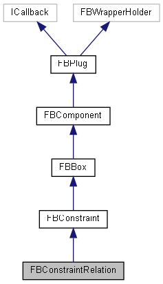

ConstraintRelation class. More...
#include <fbconstraint.h>
Public Member Functions | |
| FBConstraintRelation (const char *pName, HIObject pObject=NULL) | |
| Constructor. More... | |
| IObject_Declare (override) | |
| FBBox * | SetAsSource (FBBox *pSource) |
| Create a sender box. More... | |
| FBBox * | ConstrainObject (FBBox *pConstrainedObject) |
| Create a receiver box. More... | |
| FBBox * | CreateFunctionBox (const char *pGroup, const char *pName) |
| Create a function box. More... | |
| bool | GetBoxPosition (FBBox *pBox, int &pX, int &pY) |
| Get a box position in the GUI. More... | |
| bool | SetBoxPosition (FBBox *pBox, int pX, int pY) |
| Set a box position in the GUI. More... | |
This class exposes the relation constraint and allows addition of new boxes and removal of existing ones.
Definition at line 453 of file fbconstraint.h.
