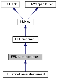

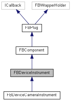

Inheritance diagram for FBDeviceInstrument:
