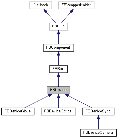

Base Device class. More...

Base Device class.
Cannot be instantiated from Python.

Reimplemented in FBDeviceOptical, and FBDeviceSync.

Reimplemented in FBDeviceOptical, FBDeviceSync, and FBDeviceCamera.
