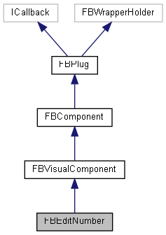

Number edit box. More...
#include <fbcontrols.h>
Public Member Functions | |
| FBEditNumber () | |
| Constructor. More... | |

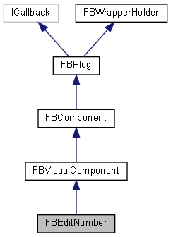

Number edit box.
Definition at line 1242 of file fbcontrols.h.
