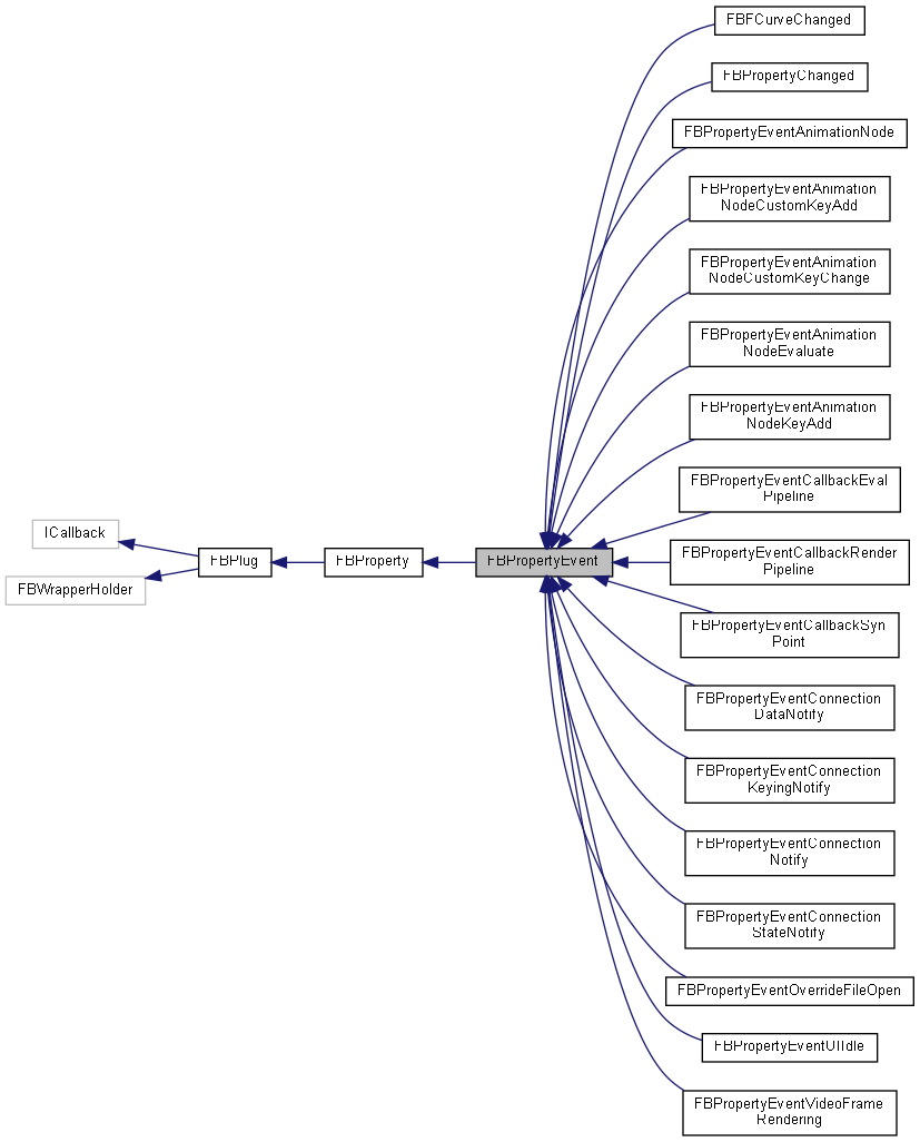

PropertyEvent: Base event class. More...
#include <fbproperties.h>
Public Member Functions | |
| FBPropertyEvent () | |
| Constructor. More... | |
| FBPropertyEvent * | Init (FBComponent *pComponent, HIRegister pParent, const char *pName, int pType, int pSubType=K_INT_MAX) |
| Property initialization function. More... | |
| FBPropertyEvent * | InitGlobal (const char *pName, const char *pGlobalEventName) |
| Property initialization function, for global events. More... | |
| virtual | ~FBPropertyEvent () |
| Destructor. More... | |
| virtual void | Add (HICallback pOwner, kICallbackHandler pHandler) |
| Add/Remove a callback. More... | |
| virtual void | Remove (HICallback pOwner, kICallbackHandler pHandler) |
| virtual void | InvalidateParent () |
| Invalidate parent, removing internal register parent. More... | |
| virtual FBPropertyType | GetPropertyType () override |
| Get the property's type. More... | |
User could register custom callback function to FBPropertyEvent and perform necessary custom tasks.
Multiple callbacks could be registered to single event, and they will called in the reverse order of registration.
User could add python callbacks via pyfbsdk (if exposed). Those python callbacks which throws exceptions will be unregistered automatically
Definition at line 514 of file fbproperties.h.
