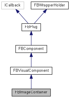

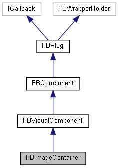

Image.
Definition at line 1205 of file fbcontrols.h.
