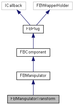

Manipulator class. More...
#include <fbmanipulator.h>

Manipulator class.
Definition at line 283 of file fbmanipulator.h.
| FBManipulatorTransform | ( | const char * | pName, |
| HIObject | pObject = NULL |
Constructor.
