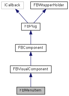

Menu Item. More...
#include <fbcontrols.h>
Public Member Functions | |
| FBMenuItem () | |
| Constructor. More... | |
| void | Set (FBMenuItemType pType, const char *pExtension, const char *pLabel, const char *pDescription) |
| Initialization function. More... | |
| bool | IsActive () |
| Is menu item active? More... | |
| void | Activate (bool pState=true) |
| Activate menu item. More... | |
| virtual void | OnItemSelectEvent (HIRegister pSender, HKEvent pEvent) |
| Internal callback function for activated menu item. More... | |
| virtual bool | Execute (const char *pFilename=NULL)=0 |
| The callback function for when the menu item is selected. More... | |

Menu Item.
Definition at line 696 of file fbcontrols.h.
