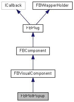

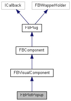

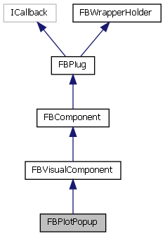

Plot Popup (for setting options only). More...
#include <fbcontrols.h>
Definition at line 2636 of file fbcontrols.h.
