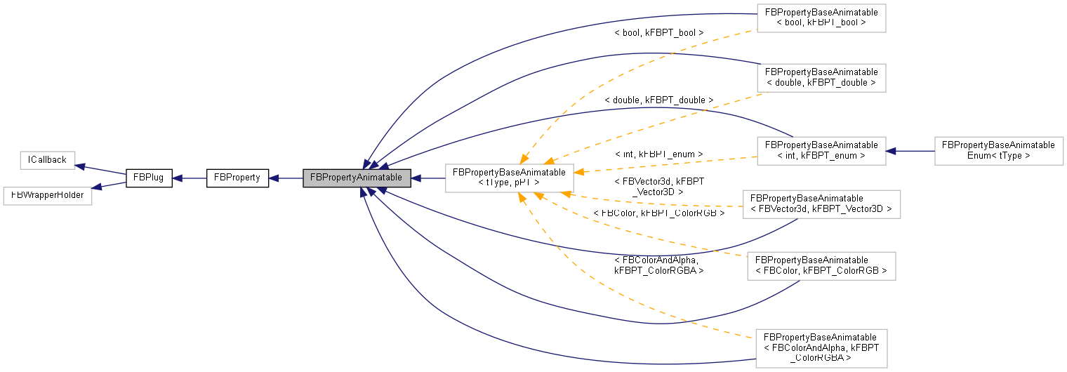

Inheritance diagram for FBPropertyAnimatable:
