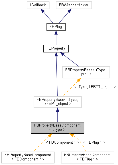

Public Member Functions | |
| FBPropertyBaseComponent () | |
| Constructor. More... | |
| FBPropertyBaseComponent (const FBPropertyBaseComponent< tType > &pValue) | |
| ~FBPropertyBaseComponent () | |
| Destructor. More... | |
| void | operator= (tType pValue) |
| Overloaded = operator. More... | |
| tType | operator-> () |
| Overloaded -> operator. More... | |
| operator tType () const | |
| Overloaded cast to tType operator. More... | |
