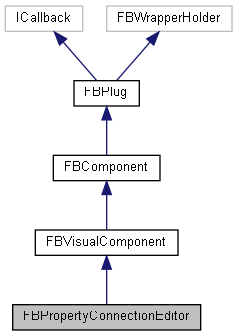

Property Connection Editor. More...
#include <fbcontrols.h>
Public Member Functions | |
| FBPropertyConnectionEditor () | |
| Constructor. More... | |
| void | PopupTree () |
| Launch a tree of object connections. More... | |
| void | PopupList () |
| Launch a list of connected objects. More... | |
Public Member Functions inherited from FBVisualComponent | |

Public Member Functions inherited from FBComponent | |

Public Member Functions inherited from FBWrapperHolder | |
