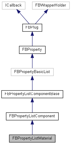

PropertyList: Material More...
#include <fbmaterial.h>
Public Member Functions | |
| FBMaterial * | operator[] (int pIndex) |
| Get the material at a specific index. More... | |
Definition at line 181 of file fbmaterial.h.
| FBMaterial * operator[] | ( | int | pIndex | ) |
| pIndex | Index of material to get. |
