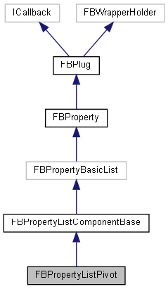

Inheritance diagram for FBPropertyListPivot:
