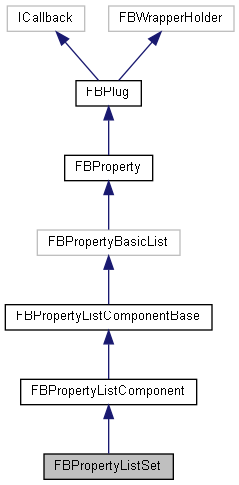

List: Set More...
#include <fbgroup.h>
Public Member Functions | |
| FBSet * | operator[] (int pIndex) |
| Get the set at pIndex. More... | |
Public Member Functions inherited from FBPropertyListComponent | |
| virtual FBComponent * | GetAt (int pIndex) |
| Get the Component at pIndex. More... | |
Public Member Functions inherited from FBPropertyListComponentBase | |
