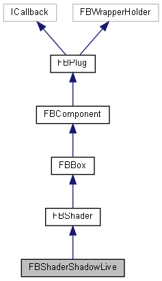

Shader Shadow Live class. More...
#include <fbshader.h>
Public Member Functions | |
| FBShaderShadowLive (const char *pName, HIObject pObject=NULL) | |
| Constructor. More... | |
