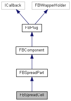

Spreadsheet cell. More...
#include <fbcontrols.h>
