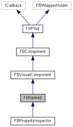

Base spreadsheet class.
Definition at line 1518 of file fbcontrols.h.
