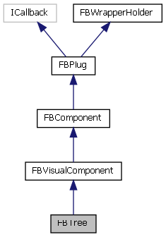

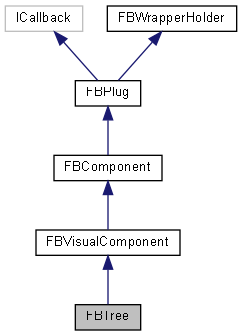

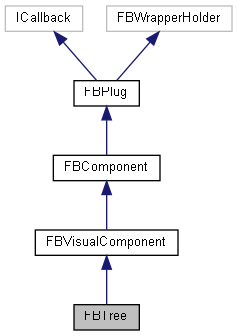

Tree list view.
Definition at line 1850 of file fbcontrols.h.
