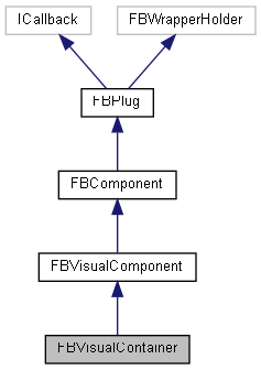

Used to create a container for a tool UI. More...
#include <fbcontrols.h>
